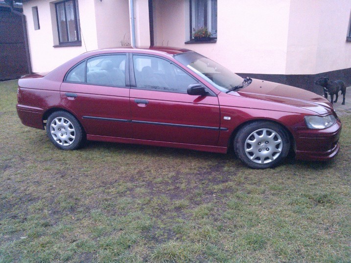

zimáky sou děs
1512493_802160586476814_607735679_n.jpg, 128.84 kB
