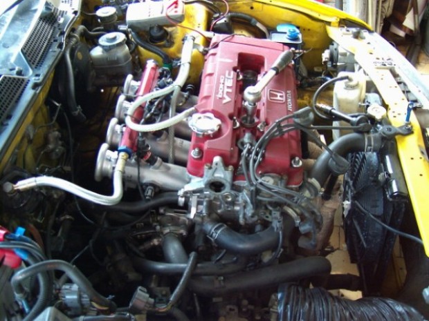

MODEL: Integra Type R DC2 2000 JDM Conversion
ENGINE: B18C6 with darton sleeves overbored close to 2000cc as possible , CP custom pistons, eagle rods, regrinded and hardened S2 stage3 cams, ST valves, springs, retainers, ported'n'flowed head, opened chambers, aem cam gears
INTAKE: TWM ITBs with custom airbox (Laughing) and 440cc RC injetors
EXHAUST: TODA 4-2-1 with 2'5 exhaust
ELECTRONICS: AEM EMS, MSD Ignitions, revised cam/crank sensors
GEAR: Spoon steel flywheel <9lbs, ACT Race disc, spoon gearset (only for few weeks as it was definitely too short for daily driving) switched to stock set with 4/5 from VTi
SUSPENSION: front/rear Whiteline Race swaybars with uniball endlinks, F/R camber kits, h&r coilovers
BRAKES: stock discs, ds2500 pads with Goodridge Braided Brake Line Kit
WHEELS: 15"/16''/17'' Rota slipstreems with Toyo R888 tires
POWER: 289ps/178ftlbs on pump/over 300/185 on race fuel
1/4 mile: 12.7s

tohle bude asi uplne top strop co se z toho motoru N/A muze dostat
Kdyz uz sme u te zivotnosti, zajimala by me u tohodle motoru, v beznem provozu. Ma tam udelane uplne vsechno. Tim myslim veci jako eagle ojnice ktere neco vydrzi, zavodni loziska atd. Si myslim ze neni duvod aby to neujelo treba 100tis, co vy na to?

No mohu psat z vlastni zkusenosti.
Motor jsem kompletne postavil na vyssi vykon (pouze znackove zbozi, ktere je provereno) ... jen klika a blok ze serie.
Vse ostatni je pripraveno na vysoke otacky a poradnej vykon.
S autem jezdim v civilu kolem 4000ot, pac setrim motor a penezenku. No obcas zaslapnu az do 8000ot, kdyz se nekdo snazi ...
Za sezonu jsem odjel tak, hmm, spocitam ... 200 sprintu, kdy auto leti az po 9200ot.
Mam najeto skoro 20 000km a rekl bych, ze se motor pomalu louci. A to mu davam veskerou peci, pravidelne serizeni ventilu, pravidelna vymena oleje po 6tkm, papa pouze a jen Racing od shellu ...
Proste a jednoduse, jsem zvedav, kolik jeste vydrzi, ale uz setrim na opravu (prestavbu na jinej obsah), pac prijde sprint kdy ... Bueee
Jen doufam, ze to bude na sprintech, a bude tam zrovna i Eso s odtahovkou Velmi šťastný
Takze asi tak k postavenemu motoru, ze co ma vydrzet je to dobrý

no a co cekas ze odejde?
loziska mas urcite acl race, ty by snad mely neco vydrzet, no ni? Úsměv pistni krouzky taky nemuzou odejit po 20ti tis km. ojnice se ti nezlomi...tak proc by mel odchazet?

Reno zapomnel napsat, ze tam lije Shell Diesel Racing.. proto je to jak traktor. HaHaaa

se me neptej, proste rachot jak ... tedy nakopnuti za studena je neco jako Tupolev pri vzletu kouř

Nedělám do závodních motorů, ale narovinu vám říkám, že závodní nemusí znamenat nejlepší. Díly jsou vždycky stavěné na určitou věc a ta se jen málokdy snese s věcí jinou. To znamená, že když mu jde o max výkon, tak zároveň s tím půjde dolů životnost. S takto upraveným motorem nikdy nenakroutí 300 tis bez nějakého většího zásahu.
Stejné jako např s brzdovejma destičkama. Koupíte drahý racingový destičky a za půl roku jsou v háji. Sice brzej jak šlak, ale je tam měkčí směs pro lepší přilnavost a ta rychleji odchází. A s tím motorem to bude podobný.
Ale ne ježdění po srazech by mi nevadil. Moc pěkný úpravy na tom motoru. I na celým autě Úsměv

no to jsou tedy vyhlídky Smutný ale myslím, že je to pravda, živostnost takovejch cca +/- 50 000 km bych předpokládal

Myslim si že by to mohlo klidně vydržet víc než 20 tisíc...při správný kombinaci dílů,příslušenství,údržbě a kvalitně provedené ůpravě je to reálný...viz Marat-jestli se nepletu tak má na tý sví raketě najeto už docela dost, a to má o pořádnou porci koní víc ( ale psal , že než toho dosáh tak ho to stálo moooc peněz a času než našel správnou kombinaci )....a to je CRX ...ITR je po motorový stránce odost lepší.
Když by to nebyl maximální ale optimální performance vůči všem dílům..tak si myslim že by nebyl žádnej problém...toť můj názor laika
Ta 4klapka bez jakýchkoli filtrů...no nevim to mi hlava nebere ..to tý životnosti motoru asi moc nenahrává Velmi šťastný ....ale jet to musí pekelně

Do CRX to je hozený kvuli váze. Původně to byl civic 6g 3d je to dobrý Už to jsou ale snad 3 roky zpět co jsem ho viděl prvně na tuningu v Přerově... joo to býval nej srázek na moravě Smutný

To bych pripsal tem Mahle pistum. Mahle delaji super pisty, ale bohuze ne pro H22.
Ta jejich "special FRM coating" se rychle opotrebuje a po te nici valce. Pokavad nepouzijes OEM pisty, tak musis vymenit vlozky valcu.

Kolik má nejeto Marat by mě moc zajímalo.

nuz porovnavat sleaved block z ameriky a vyvoj za pol mega s cimkolvek inym co poskladas aj v garazi je troska odveci...
a crx vs itr (co sa tyka motora) zase ziaden zasadny rozdiel nie je.
ak sa bavime o N/A motoroch, ktore maju kompresiu cez 11, kovane piesty, agresivne vacky, tvrde dvojite pruzinky, brutalnu mapu, tak sa nebavme o tom, ci niekto jazdi 4000rpm alebo 9600rpm. skratka material ma svoju zivotnost. moj motor vydrzal cca 25tisic km kym sa utrhol ventil... a nebolo to sprintami, ale prave tymi km, skratka ventil (moje boli original honda) na tvrdych pruzinkach dostava zabrat aj na volnobehu, zivotnost treba pocitat na odjazdene hodiny a nie km.

Pokud se nepletu,před prvním letošním Vyškovem říkal,že má 10tkm prakticky v omezovači muhehe

pise, homemade airbox, takze neco pro filtraci tam urcite ma Mrk

To sem myslel že ITR motor je teda lepší Se stydím .....nj asi máš pravdu..máš stím zkušenosti.
Ale to jako fakt nejde postavit B18C6 s třeba 250 koňma N/A aniž by vydržela 200 tisíc ?

Je to tam.
